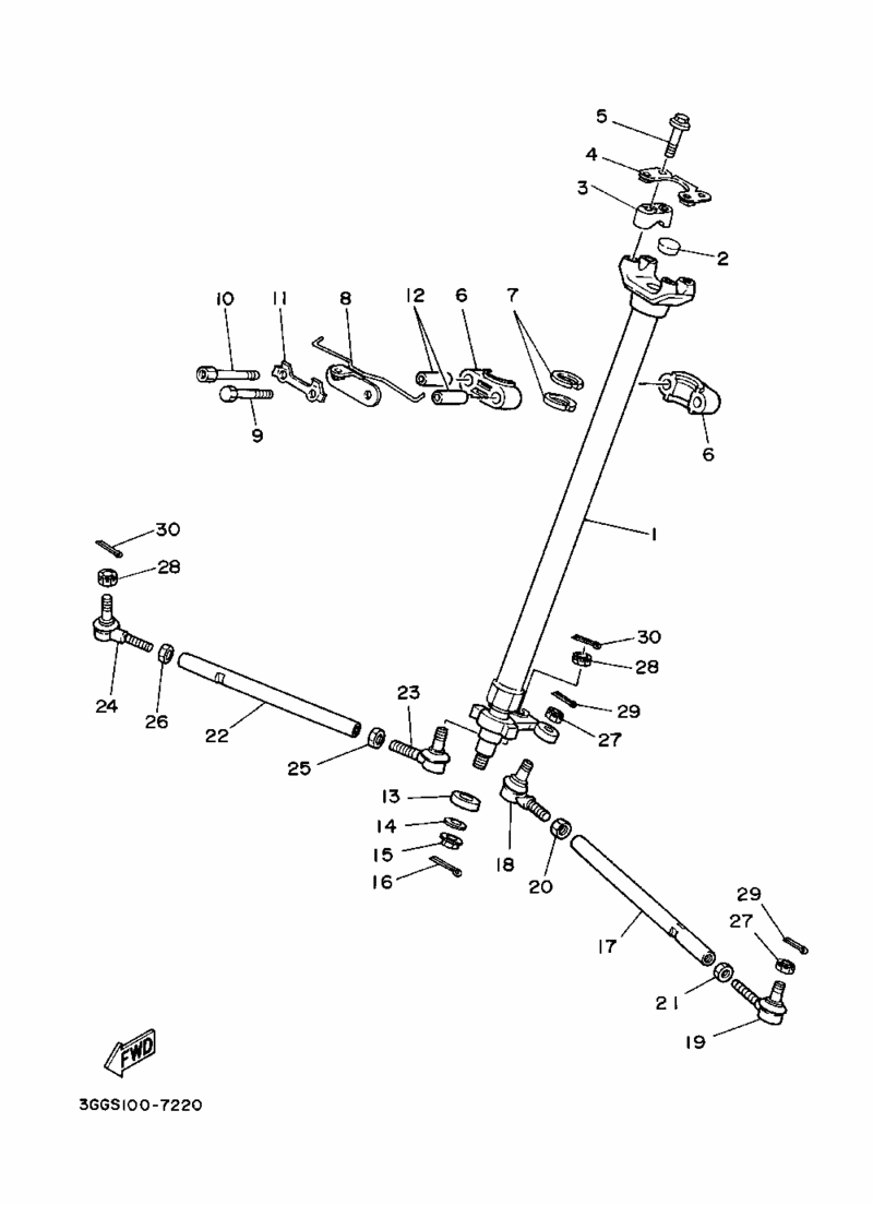

Est ce que quelqu´un aurait les references du roulement et des 2 joints.
Merci, @+ José

Roulement de Colonne de direction 1002_s10
2 PLUG,TAPER (U49)
90336-28053-00
1 $3.56
3 HOLDER,HANDLE UPR (U49)
1E6-23441-00-00 (replaces 8K1-23814-00-00)
2 $18.56
4 STAY (U49)
2GU-2629K-00-00
1 $7.26
6 BEARING,STEERING (U49)
1UY-23812-00-00
2 $8.41
7 OIL SEAL (1UY) (U49)
93112-31011-00
2 $2.77
8 BRACKET,STRG LOWER (U49)
2GU-23868-00-00
1 $15.88
9 BOLT,HEXAGON (U49)
97017-08060-00 (replaces 97027-08060-00)
1 $2.54
10 BOLT (U49)
90109-082E9-00
1 $6.78
11 WASHER,LOCK 1 (U49)
1UY-23894-01-00
1 $1.11
12 COLLAR (U49)
90387-106T4-00 (replaces 90387-090R0-00)
2 $6.64
13 COLLAR (U49)
90387-176R6-00
1 $4.24
14 WASHER,PLATE (U49)
90201-10774-00
1 $2.29
15 NUT,SELF-LOCKING (U49)
90185-10115-00
1 $2.46
16 PIN,COTTER (U49)
91490-20025-00 (replaces 91401-20020-00)
1 $1.16
17 ROD,TIE (U49)
2GU-23831-01-00
1 $13.74
18 JOINT,UNIVERSAL 1 (U49)
1UY-23841-01-00
1 $43.76
19 JOINT,UNIVERSAL 2 (U49)
1UY-23845-01-00
1 $43.76
21 NUT,HEXAGON (L/H THR (L.H. THREAD) (U49)
90170-10186-00
1 $2.29
22 ROD,TIE (U49)
2GU-23831-01-00
1 $13.74
23 JOINT,UNIVERSAL 1 (U49)
1UY-23841-01-00
1 $43.76
24 JOINT,UNIVERSAL 2 (U49)
1UY-23845-01-00
1 $43.76
26 NUT,HEXAGON (L/H THR (L.H. THREAD) (U49)
90170-10186-00
1 $2.29
27 NUT,CASTLE (U49)
90171-10046-00
2 $1.47
28 NUT,CASTLE (U49)
90171-10046-00
2 $1.47
29 PIN,COTTER (U49)
2 $1.16
30 PIN,COTTER (U49)
2 $1.16
